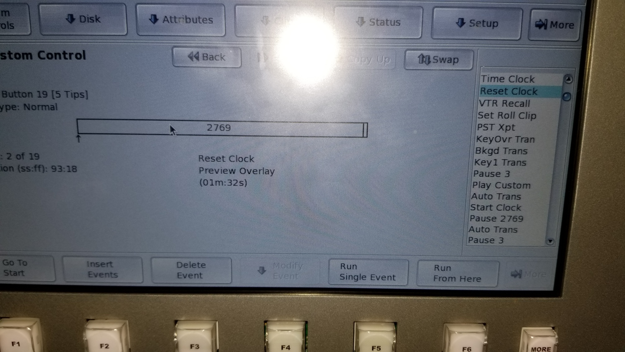

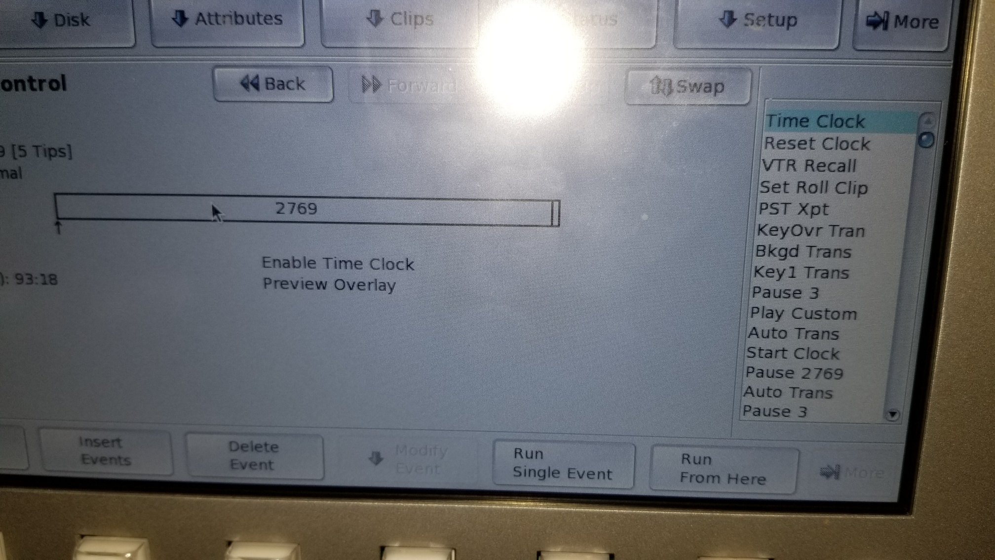

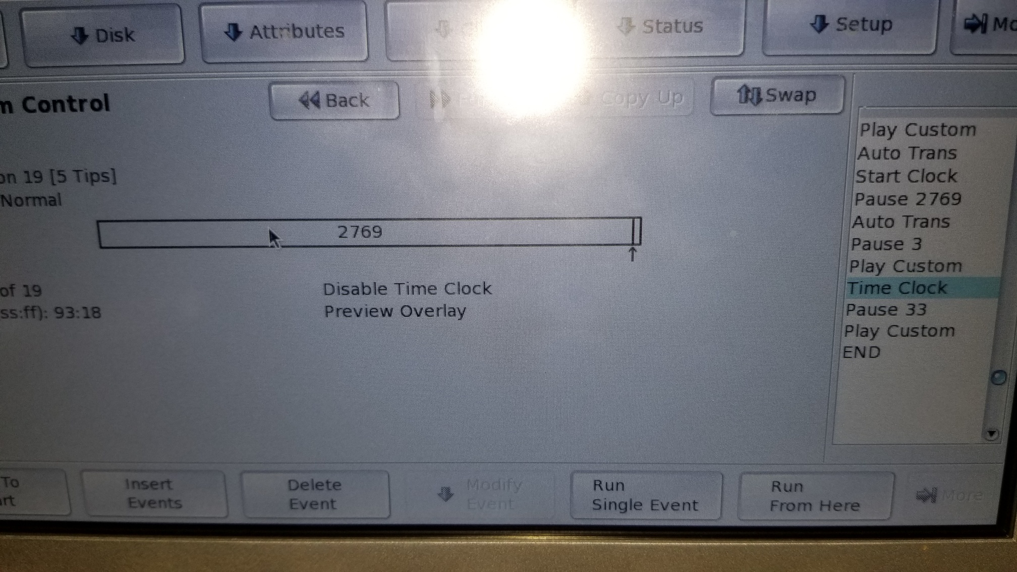

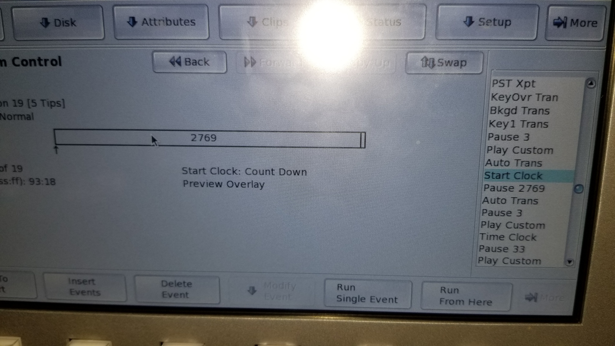

    Having problems with the timer overlay and Custom Controls. It has worked in the past but now no longer does. I have the time reset for different time breaks in each CC, but the time keeps re-setting to the last time break I make. Dont know what I may be doing wrong.
    Running 17.2A
    Here are my screen grabs
    Any help would be grand! many thanks

    I would check to make sure that the Transition has not been configured in the Time Clock Setup...  It might be tracking Based on it...  So if the MASTER is on and the PGM ME is ON then when you do an auto trans it is going to auto reset to the config in that menu..
