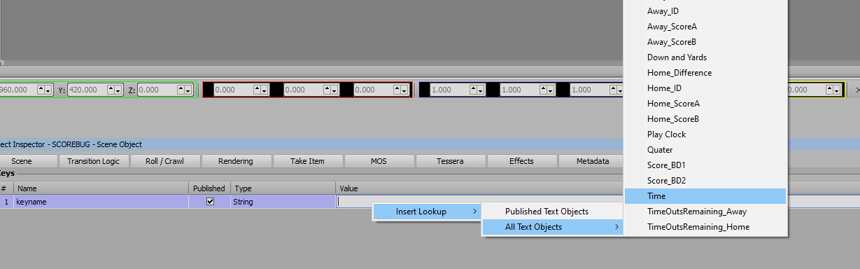

    Is there a way to have the Datalinq Key's value change based off of a text object? I've attached a screenshot to help explain what I'm talking about.

    Right-click in the field and choose a text object.
    Or you can just write @textobjectname@
    Just put the text object name between "@"
