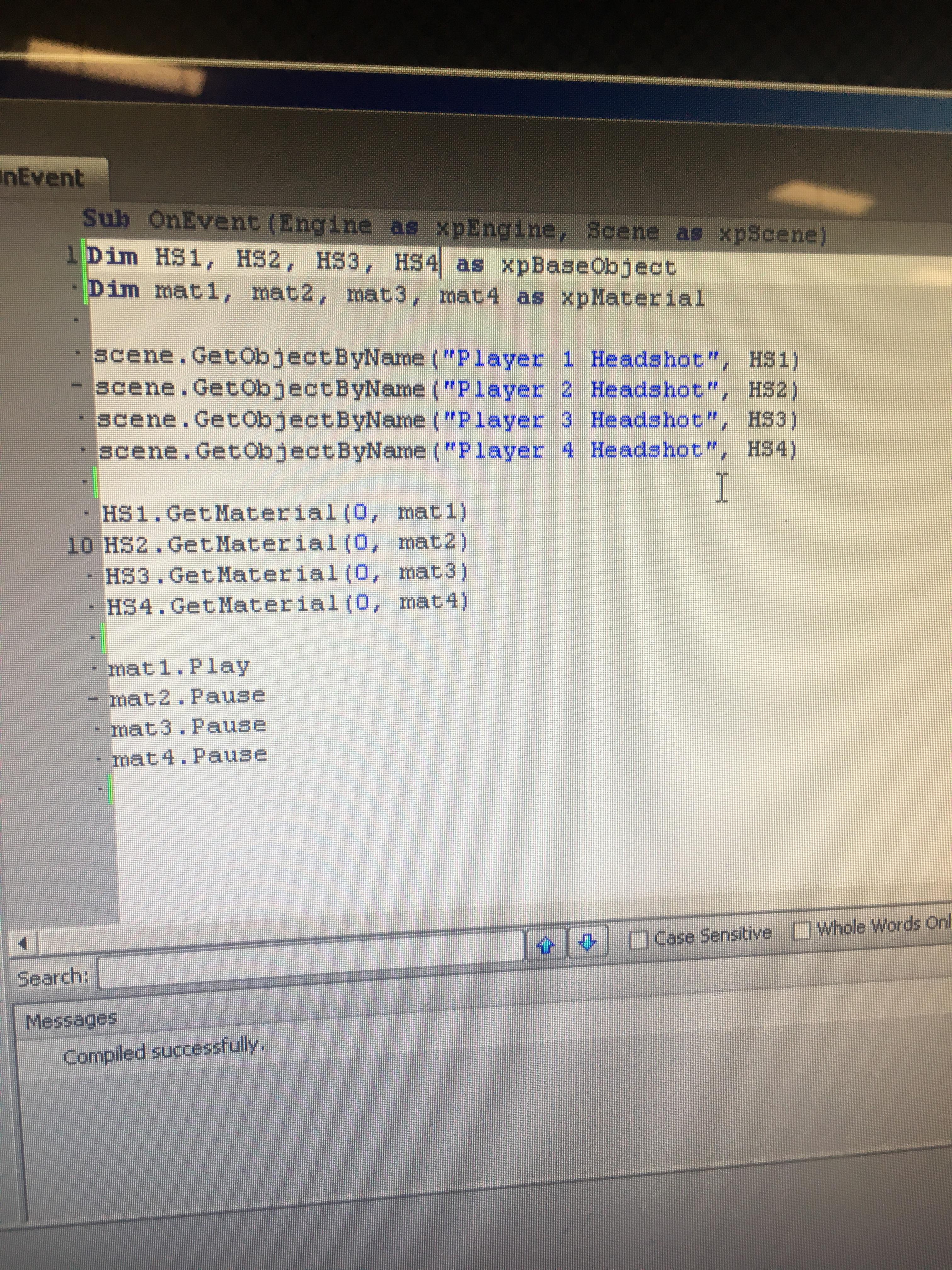

      1. You could put a script in the scene director where the video clips are playing out of.  Define each quad that the videos are attached to as materials in the scene.  Then make sure that the video material that it is attached to is not set to auto start, and then have your script actually start the video at the frame in the scene director where you want it to do that.
      2. If you bring your materials into the scene director themself, then they would play when that scene director play head position gets to there. - This way is a little less flexible if the scene has changing videos.  This is more the workflow if the video that is always being used.
    Sorry that the attached image is rotated, blame the website.  This is a basic version of a script that I have used to accomplish this.  The script was an event placed on the scene director and not on an object in the object manager. - The extra pauses at the bottom of the script are in theory overkill.  It was more so just a backup to make sure that the videos came onto the scene and were not playing yet.
