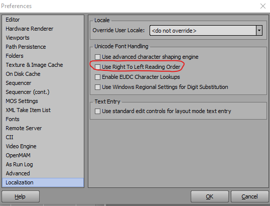

    This is possible. If the project is mainly in Arabic, then I'd recommend you set the Right To Left Reading Order in the preferences as per below. Will make your life easier!
    When you enter text in XPression, if you've set the Right To Left Reading Order, there is a new Text tab on the object inspector for text objects. This is the easiest place to enter text.
    If you right click on a text box, there is also an option (Text Layout) to change just that box for Right To Left reading. Use this if you've not set the whole system to be Right To Left.
