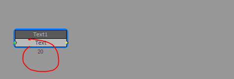

    How to convert postive number into negative number in xpression designer ???..
    like ::
    I want to  convert 20 value into negative in visual Logic editor. i.e -20

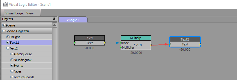

    The same way you usually do in maths, multiply that number by -1.  but it requires a hidden text box as you'll need 2 textboxes to avoid conflicts.

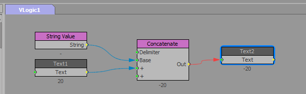

    Or you can simply add a "-" to the string this way if you prefer.
    Or again to avoid two text boxes you could place this script "ononline"
    dim text as xpTextObject
    self.GetObjectByName("Text1", text)
    text.Text = ("-" & text.Text)

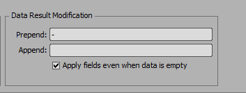

    Or if the value is coming from datalinq you can preappend with a "-" in the settings.
