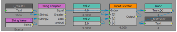

    I use this new block of logic as a base, then different blocks of Datalinq lookups modify from there, <@i_firstExotic@+0> +1, +2, etc.

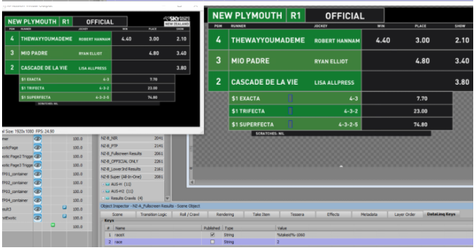

    Within the graphics though, these blocks don't want to flow through all the way to screen immediately.
    If I write in a Data Key and press Enter, most of the graphics take, but they are incorrect/not complete:

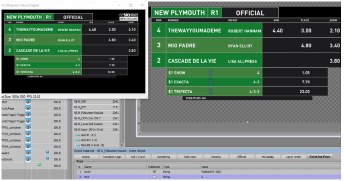

    Then, if I select and press Enter on the Data Key again, no changes, they graphics will correct themselves (notice above the "Exacta" block is missing, and below it returns and pushes the following bets down, correctly):

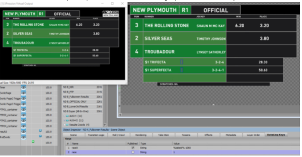

    Another similar example below:
    This works similarly on the production side (without a way to re-trigger the Data Key and get the correct data) and I've tried tweaking and moving where the Visual Logic resides to no avail.

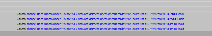

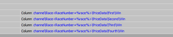

    I actually have a certain logic tab done two different ways; one is working perfectly, and the other is having the same issues where it takes multiple pushes to get all the data updated on screen.
    The only difference between these two logic tabs is the actual queries being made by the Datalinq blocks.
    The working one looks like this:
    And the non-working ones look like this:​
    Through the process of building and small tweaks, the only thing I can figure is the issue lies with the double filter happening on 'PriceRecord' where both the poolID and results are controlling the query.
    Has anybody else seen this sort of issue or glean if I'm doing something wrong?
