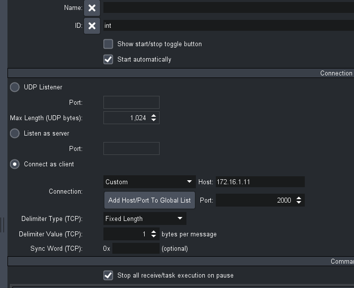

    and a screenshot of my listener setup:
    I'd be really grateful for some help with this one please.

    I've never used "Fixed Length" delimiters, and it seems a little odd that each one is just 1 byte long.     But I guess it's possible if you're just sending one byte messages.  Although your ogscript code seems to expect multiple bytes.
    I typically use the "New Line" delimiter, and make sure that all my messages end with new line characters.    That way I can have variable length messages coming through.
