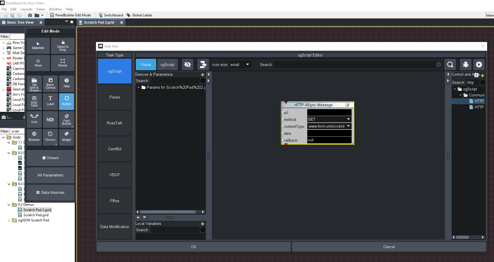

    Is it possible for dashboard to call a REST endpoint?

    I recommend the ogScript call to asyncHTTP for the most control out of RESTful endpoints.
    It is available as a Visual Logic Block or regular scripting template in the Script Palette. The calls provide configuration for HTTP action type, content-type, etc. With the scripting version (as opposed to Visual Logic), you can also add additional header arguments if you need them.
