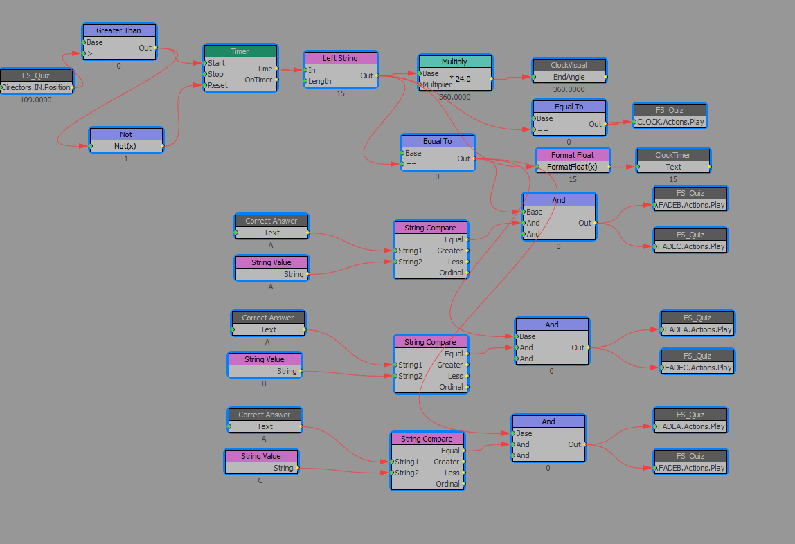

  • 3.  RE: Building a trivia full screen graphic
    Posted 01-11-2022 05:27
    I would use visual logic to do it. Here the example uses a timer and compare blocks to reveal the correct answer.
    However you only really need to the compare part to do what you need, in the example above the client also wanted a visual countdown as well hence the first part of the logic.
    Test Pilot | Senior Graphic Programmer & Designer
    London United Kingdom
  • 4.  RE: Building a trivia full screen graphic
    Posted 01-11-2022 10:37
    Thanks for the reply and the VL sample, Red.  I'm wondering how I'd go about distinguishing which answer is the correct one? Do I have to add something to the scene, such as a dropdown where the producer selects the correct answer each time?
    Ed
  • 5.  RE: Building a trivia full screen graphic
    Posted 01-11-2022 10:51
    Yes you can make a combo box drop down with the correct answers.
  • 6.  RE: Building a trivia full screen graphic
    Posted 01-11-2022 13:55
    I made the combo box drop down for the answers and here's my VL, but it's not quite working right. Each answer choice has its own Scene Director. Originally the Scene Director for A was set to default but then A was the only one that faded out everytime I ran it in the Sequence. I created a Null Scene Director and made it the Default, but that didn't solve the problem. Any suggestions?
    Ed
  • 7.  RE: Building a trivia full screen graphic
    Posted 01-11-2022 14:05
    What behaviour are you having now?
    If you press Alt+V you'll see the data in each block the same as in my example.
  • 8.  RE: Building a trivia full screen graphic
    Posted 01-11-2022 14:41
    I did the Alt V and put the data in each block. It's strange because answer choices C & D work as expected, meaning that the other choices disappear when either C or D is chosen in the combo box as the correct answer. However, if I chose A or B as the correct answer, option C does NOT fade away for either one of those answers. Not sure why this is happening as the fade boxes on the right are copies of each other.
    Ed
  • 9.  RE: Building a trivia full screen graphic
    Posted 01-11-2022 17:24
    Sounds like either your animation or logic is wrong to me, go through a double check everything one by one, make sure your animations are correct, most likely its an issue with your logic by the sound of it so check each block is exactly what you expect it to be, especially which animations are being triggered.
  • 10.  RE: Building a trivia full screen graphic
    Posted 01-12-2022 15:26
    So I got my VL working well. Thanks for your help with that. All is good there. If I wanted to take this one step further and have the correct answer also change to a different color, what's the best way to do that?
