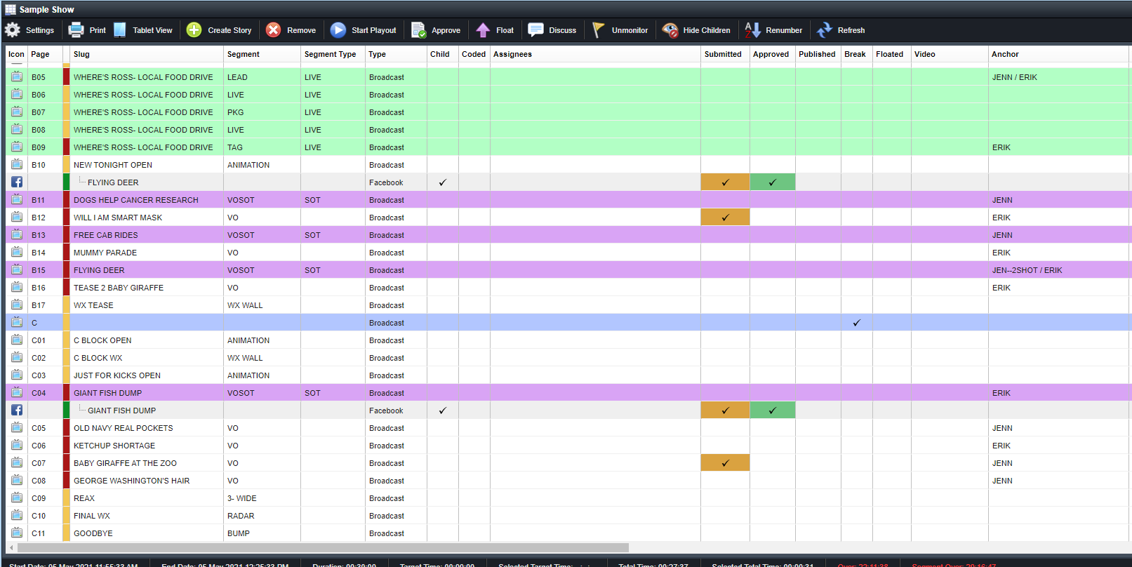

    We have several MOS columns in the #Inception RO that display MOS information- currently there's no way to separate these out into separate columns, HOWEVER, there are some manual workflows you can set up to distinguish between a story that has video, and a story that only has graphics. The best example is with custom colors for rows in the Running order.
    Here's an example of how this might look:
    From there, as far as the duration goes, the "Media Time" column could be used (through the Media Time production cue) to distinguish media TRT within a story where packages and other pre-produced content is concerned.
    If this is something you'd like to try, here's a video on InceptionU that can help!
    https://www.rossvideo.com/gallery/custom-columns/
