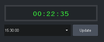

Hi Bobby
I have attached an example panel that takes a time of day (24-hour clock) in a text field and updates the stop value of the timer to that value. The tricks here are to:
- Use "Time of Day" timer type
- Use script to grab the timer's "formatter" and use it to convert your text into a value the timer can understand (that's in the "Update" method)
For some extra ease-of-use, I have also set the widget for the text field to our built-in time picker. If you keep this, you will want to make sure its w.format property uses the same time format as the timer.

Cheers
James

Hi Ben,
I think I sort of got it but I am not sure how to edit the time I wish for it to count to. I changed the type of clock to "Count Time Until" but I'd like to create a field in DashBoard where I could enter the "Stop Time", this is where I am getting stuck as I don't know what variable to replace in the source. If it helps you, I replied to Malcolm in this thread what I am trying to do.
Thanks!
