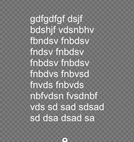

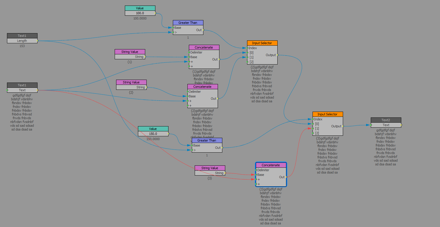

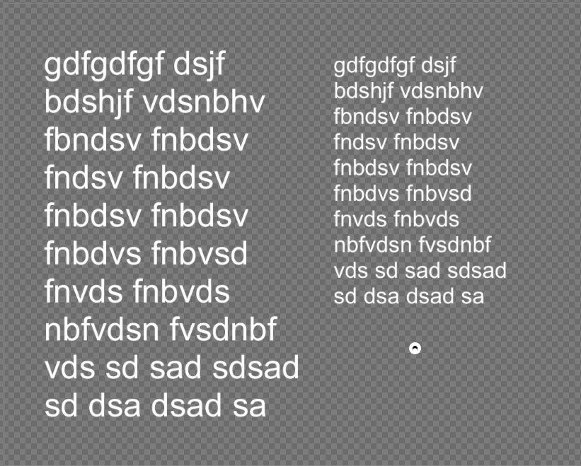

Here's something I have quickly just put together as a rudimentary way to avoid that loop that would allow 3 sizes in this instance, obviously you can take it as far as you like.
In the final result you would publish only text1 but it would be invisible and unpublish text 2 but it would be visible.
FYI you don't need to apply the word wrap to text 2, it is copied with rest of the text.
Final user would see

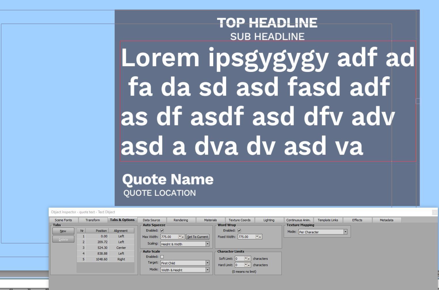

I'm still stuck on this. I can't figure out how to constrain the height of the text bounding box, so the text auto squeezes by width and height as more text is added.

unclick the enabled on auto-squeeze.
hit set to current - does your number change (775)?
re-hit enabled on auto-squeeze
not sure about the word wrap

This is where I'm at. The text is expanding vertically from the center. But it will go on forever. I need the text to auto-squeeze (width and height) so the text gets smaller as more is added. Plus, the overall text bounding box needs to be constrained in the space between the headlines and the quote name. I set the auto-squeeze, but it's not working.

Try following this simple visual logic I use for a lower third that is usually one line of text, but sometimes goes into 2 lines. You will have to play with the numbers to adjust to your graphic size.
It centers it on the X & Y.
