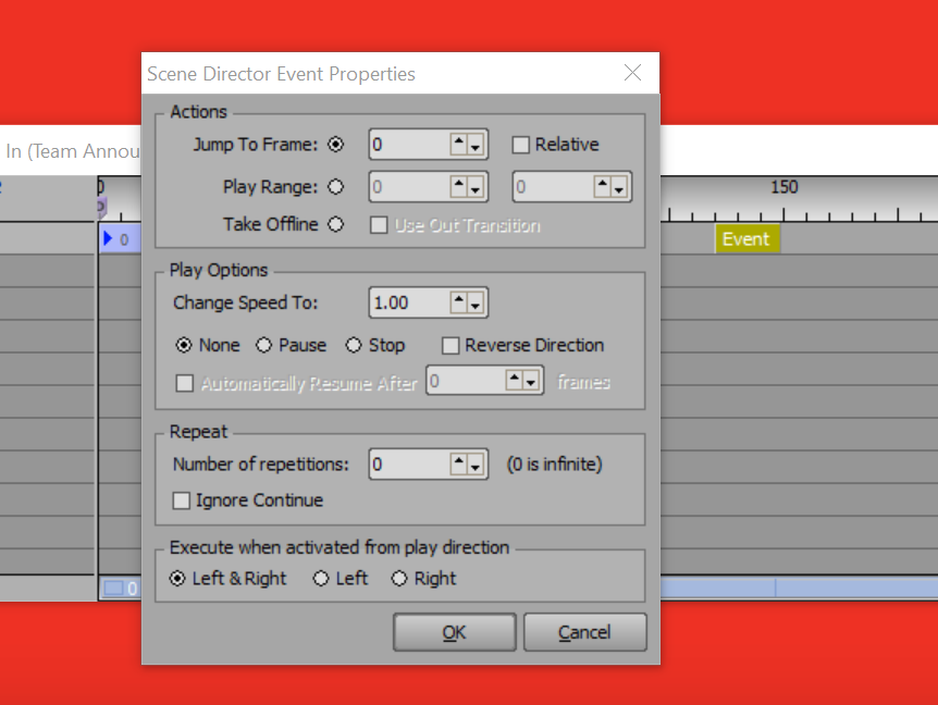

  • 4.  RE: Adjusting the speed of an AVI v10.5.5532
    Posted 10-28-2022 07:15
    If it's set to autostart this overrides anything you do when placing it on a scene director.
    You will need to make it loop by using an event on the scene director.
