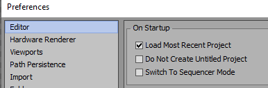

    There's this option in preferences.
  • 3.  RE: Automatically Load Project on Startup
    Posted 11-25-2022 06:10
    I've seen that, but with 4 projects loaded I don't think theres a way to guarantee which one it will consider to be the "most recent."

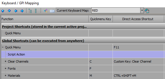

    You could try this.
    Make yourself a custom keymap that's always in XPression.
    I've made one here called RED.
    Add a script action. (Make sure its in Global and not Project Shortcuts)
    Set it to be fired by a GPI so external device such as a ross switcher or dashboard can fire it or something like an Streamdeck.
    Or a keyboard shortcut.
    On that GPI have a script like this.
    dim project as xpProject
    Engine.AddProject("C:\Users\awisniewski\Desktop\gpi test.xpf",true)
    Engine.GetProject(0, project)
    Engine.SetActiveProject(project)
    You'll probably want this ticked as well to avoid having to projects.

    That is what we currently have, and we have tied it to multiple keyboard shortcuts to try to eliminate the risk of an operator forgetting to load it, but sometimes they still manage to get around it by loading it through the windows explorer instead of a macro. The only other option I could think of is to just make a shortcut that opens the .xpf file from Windows directly, which will open it.
    So to confirm then, XPression does not have this functionality?
    Jack Reynolds
