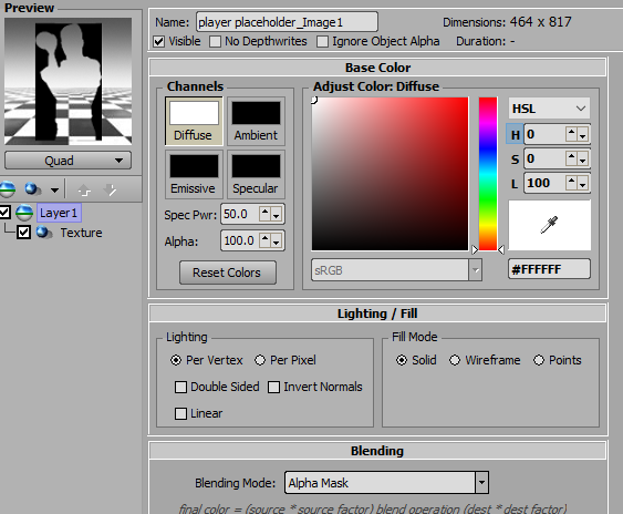

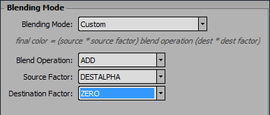

    Structure the Image and Color like this:
    And set the blending mode for "LayerObject2" to this:
    The color can technically be anything - in my case I needed white.

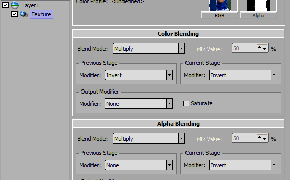

    What I do is is make a material and set the blending to alpha mask
    Add a texture shader for the image.
    Then I invert the current stage modifier.
    Add another standard layer and put that above the original
    Place objects in a layer object to see blending.
