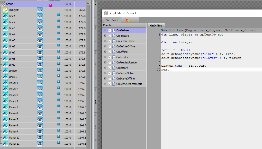

    however this quite slow so a loop would work well onOnline;
    dim line, player as xpTextObject
    dim i as integer
    for i = 1 to 11
    self.getobjectbyname("Line" & i, line)
    self.getobjectbyname("Player" & i, player)
    player.text = line.text
    next
    it's best to put the same script in OnPreviewRender as well so you see it preview.
