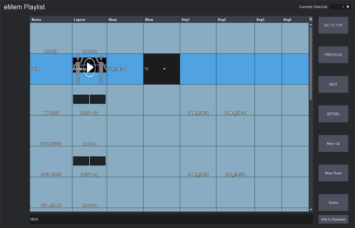

    I have built a table based on a tutorial by Ben Gatien on structured parameters
    I'm using the playlist to drive sources to monitor arrays and split effects on our Carbonite Black.
    This task adds a new item to the bottom of the playlist.
    <task tasktype="ogscript">var newrecall = {
      Layout: params.getValue("Layout",0),
      Abus: params.getValue("Abus",0),
      Bbus: params.getValue("Bbus",0),
      Key1: params.getValue("Key1",0),
      Key2: params.getValue("Key2",0),
      Key3: params.getValue("Key3",0),
      Key4: params.getValue("Key4",0),
    var count = params.getElementCount("recalls");
    var p = params.getParam("recalls",0);
    p.setValueAt(count, newrecall);</task>
    For late changes, my directors are asking about adding a new item in a particular place.
    I'm thinking that the "add new item" combined with elements of the "move up" function might get me close, but I am afraid it might also break every item below the insert point.

  • 2.  RE: DashBoard Structured Parameter Table
    Posted 04-29-2023 15:49
    It occurs to me that since I also have wanted to duplicate an existing row in the table, maybe I could use a duplicate function to accomplish both goals.
    I would have the selection that could determine where to add the new recall..with selection or index+1.
    I do not know Javascript or ogScript, so I am just stabbing in the dark here.
    I did try to make the add items and in one attempt, deleted the whole table---just like I feared, it all came crashing down.
    Is this possible?

      I was able to get you an 'insert below' function working here is the code:
    var newrecall = {
    var allValuesArray = params.getAllValues("recalls");
    var selectedRowIndex = params.getValue('selection', 0);
    // Insertion is below the selected row
    var insertionIndex = selectedRowIndex + 1;
    // Array.slice includes first index, excludes last index.
    var firstElementsArray = allValuesArray.slice(0, insertionIndex);
    var lastElementsArray = allValuesArray.slice(insertionIndex);
    // Add the new element to the list and concatenate them
    firstElementsArray.push(newrecall);
    var resultingArray = firstElementsArray.concat(lastElementsArray);
    // Update the values of the table
    params.setAllValues("recalls", resultingArray);
    // Set the selected row as the one which was just inserted
    params.setValue('selection', 0, insertionIndex);
    The only drawback is that you cannot insert an element as the first one in the list, but with this example I think you can easily figure it out if you need to.
