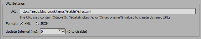

    http://feeds.bbci.co.uk/news%edition%/rss.xml
    and macros "edition":
    "" - empty without text for top stories
    "/uk"
    "/politics"
    "/education"
    etc.

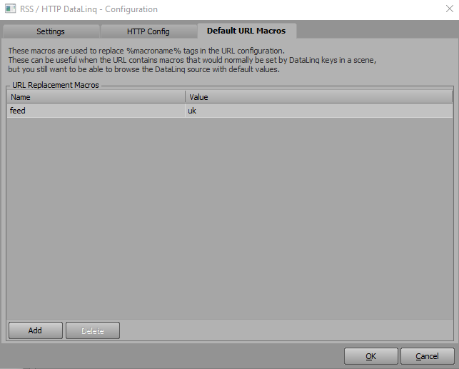

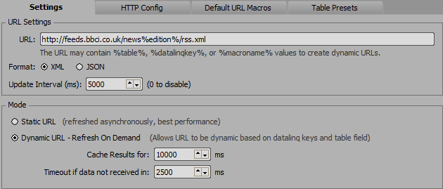

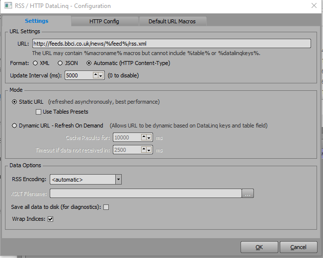

    Thanks for all your help with this. The way I want to implement this works if I use Dynamic URLs, but not Static. No reason why I can't use Dynamic, but would like to know why the Static version fails. If you open the log viewer in Datalinq, it comes up with invalid URL, which it would do if the %feed% macro is not being expanded.
    What is wrong the the way I have this as per below? It's as if in Static URL mode, any macro in the Default URL Macros tab is being ignored. Switch it to Dynamic, and it works.

    Static mode only works with direct URLs, no macros. Macros can only be used in Dynamic mode.

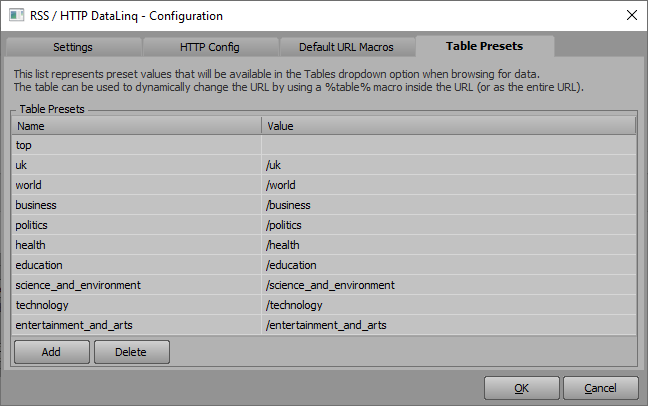

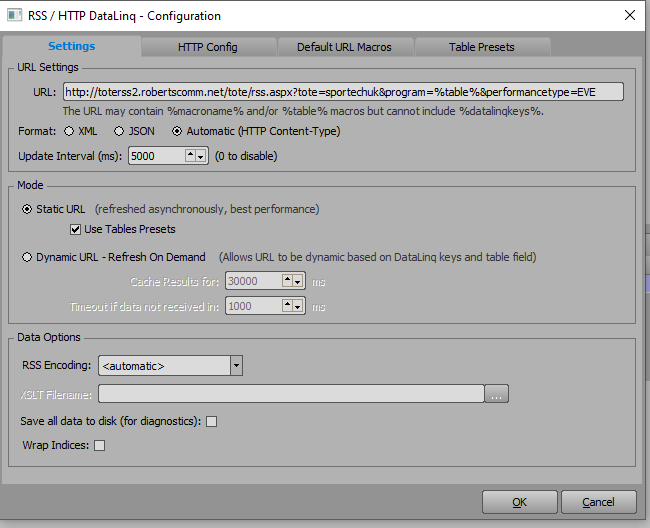

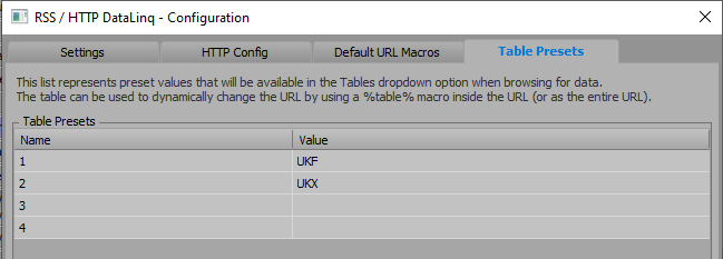

    So, the table that Roma showed you will work with Static, you just have to check the Use Table Presets checkbox under Static URL.

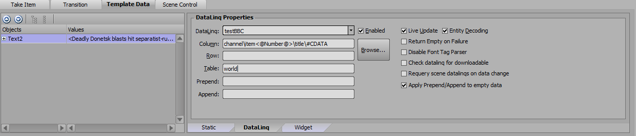

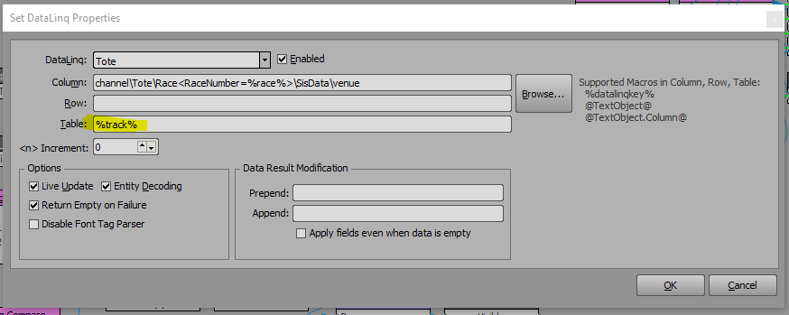

    What I do is use a %DatalinqKey% or @textMacro@ in the Table field for the datalinq in XPression, and have that object as a Template Link so as you build your sequencer, you can tell the scene which URL you want it to use.

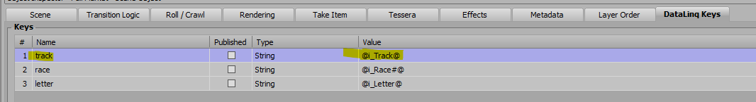

    Using the %track% datalinq key to determine which URL to use:

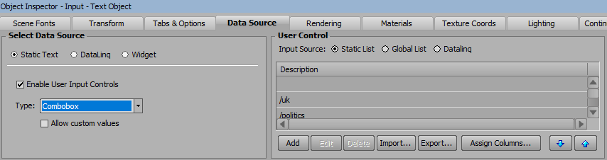

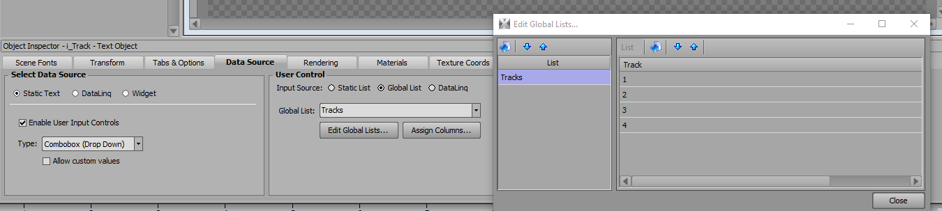

    Datalinq Keys are just tied to Text Objects in the scene:
    The i_Track text object Data Source:

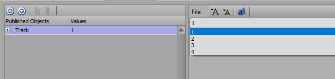

    The Published Objects for the scene in the Sequencer:
    Could be cleaner for sure, but I have it abstracted in a way that hopefully an Operator could add new scenes to the Sequencer if the occasion arose that they needed to and I wasn't available.
