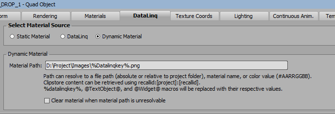

    If you are on newer version of XPression you could use dynamic materials and datalinq keys.
    The datalinq key can be a value or even you can use %relid% which takes the number relative to your takeID.

    Well relid only works with humbers.
    You need to replace the word of the file with a macro.
    eg, D:\Project\Images\101-@Text1@.png
    Text1 would be a published field that you could type today's name into.
    If you want to combine with relid id you could write;
