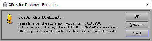

  • 10.  RE: Get error when try to script
    Posted 11-03-2022 04:05
    This is the error I get, when I try to compile
    This is, with just small snip of code:
    dim kreds as xpBaseObject
    self.GetObjectByName ("1", kreds)​
    And it would not compile...
    It works on another XPression machine.

  • 11.  RE: Get error when try to script
    Posted 11-03-2022 15:27
    Did you re-install XPression Designer?
    Do the systems have Windows set to different languages?
  • 12.  RE: Get error when try to script
    Posted 30 days ago
    I just did a new install of XPression Designer and took the new version 10.5
    Now it works!
