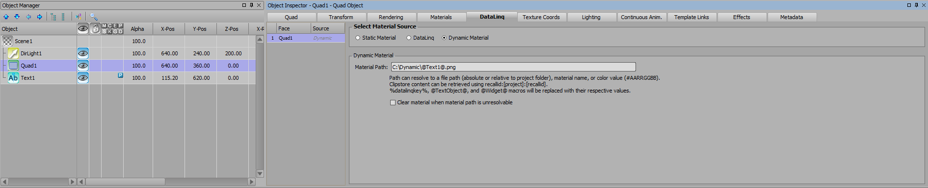

    It sounds like a dynamic material would work for you.
    Datalinq a text object "Text1" to the name of the team.
    On the logo quad, go the object inspector datalinq tab and choose dynamic material radio button.
    In the material path C:\Dynamic\@Text1@.png
    Save your team logos to that folder with the exact names from your data.
    I think the @Text1@ macro may be case sensitive...and it seems like punctuation/special characters might break it.
    Hope this helps,
    James.​
