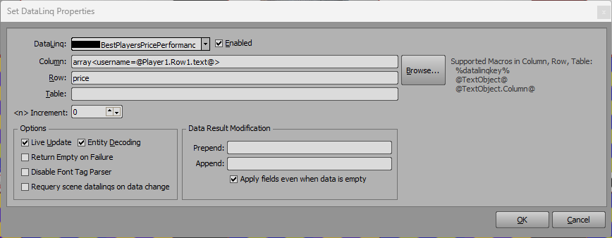

    Hi! Through some digging in the forum I found an awesome shortcut that allows me to search JSON files  for specific key-value-pairs using this method in the "column" section on Set Datalinq Properties and then use the "row" section to search any child attributes. Was curious if there are other shortcuts that we could be using for JSON and CSV providers (our two most common types in esports).

    Here are a few more comparison keys that are available:
    • The XML/JSON datalinqs can now search multiple attributes or elements to return a node that matches all search criteria.  e.g. players<team=NY;jersey=10>
    •  A DataLinq comparison key such as <club=ross> can now have an additional index parameter as well, like so <club=ross<2>>, which will retrieve the second item matching the key.
    • The XML datalinq types can search for children elements/attributes in a level of the tree by using "childname.field=%key%".  e.g. player<info.jersey=%num%>\name
