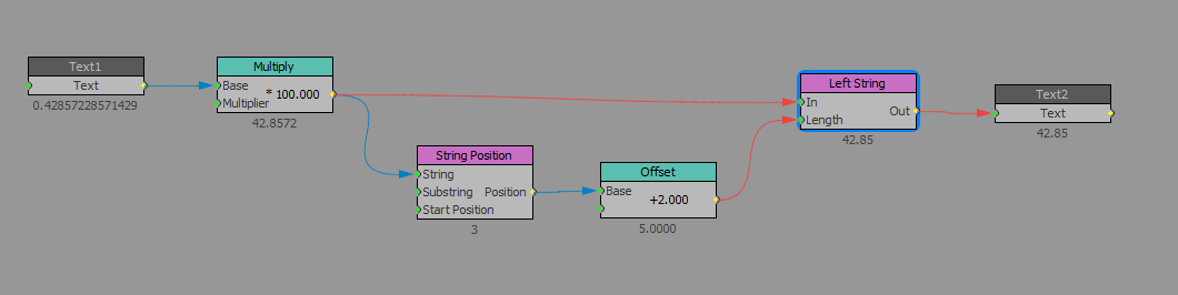

  • 5.  RE: Rounding Decimal points
    Posted 10-27-2022 13:36
    Rob.
    If you are using VL it is better to create schema below.
    Roman Yaroshenko

  • 6.  RE: Rounding Decimal points
    Posted 10-27-2022 15:16
    Hadn't thought of that.  Nicely done!
    Rob Blank
  • 7.  RE: Rounding Decimal points
    Posted 10-27-2022 17:50
    This is awesome! Thanks for the help!
