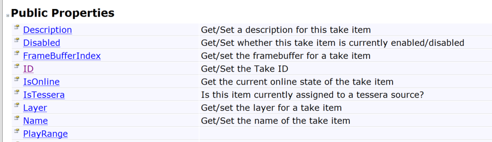

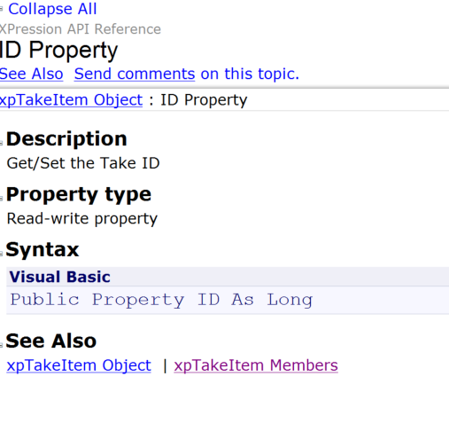

    xpTakeItem.ID
    Its a read and write property.
    So this example would renumber the take ID.
    dim take2 as xpTakeItem
    engine.sequencer.getTakeItemByID(1000,take2)
    take2.ID = 2000
