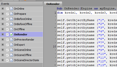

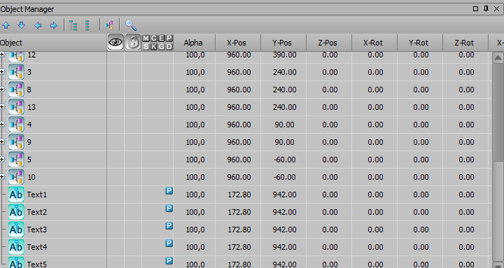

    Nothing seems to happen
    I've put the script in here:
    Like this:
    I have the groups here and text input

    Posted 11-02-2022 05:31
    Hi,
    You write
    if inp1 = "701" then​
    should be -
    if inp1.text = "701"​ then
    Your script is so big. Why don't you use loops? And why do you define 13 xpbaseobjects if you are using only one?
    Try it
            Dim kreds(12) As xpBaseObject
            For i As Integer = 0 To 12
                self.GetObjectByName(CStr(i + 1), kreds(i))
            Next
            Dim inp(4) As xpTextObject
            For i As Integer = 0 To 4
                self.GetObjectByName("Text" + CStr(i + 1), inp(i))
            Next
            kreds(0).Visible = False
                If inp(i).Text = "701" Then
                    kreds(0).Visible = True
                    Exit For
                End If
            Next

  • 3.  RE: Script won't work
    Posted 11-02-2022 09:12
    This script should be converted into visual logic. Running scripts in OnRender events is generally not recommended. The use case for this script will be more stable and execute better as visual logic.
