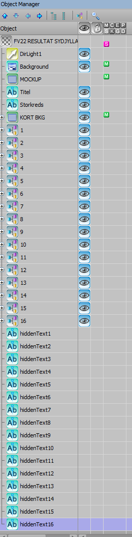

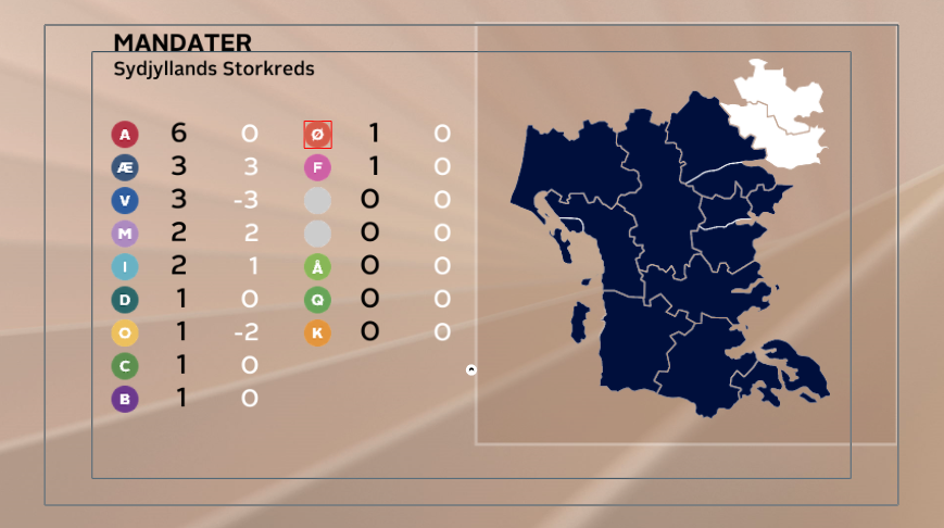

    Basicly, what I want, is to readout data from the json link I have.
    I get this for each party:
           logo        -        percent          -          +/- percent
    16 partys
    These are now all my objects:
    I need to sort the partys, based on the black number and then place them at the right position.
    At first, I sortet with visual logic, but i did'nt sort them right.
    Therefore I need to sort them another way.
    I have tried as you describe, IT works, when I put it on the OnRender in scrpt!
    But I also need to move the logo and the +/- with the percent...
    Tue Sandbæk
    Director / TV-Technician
    TV SYD
