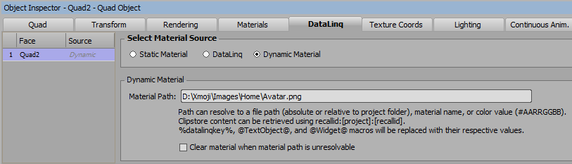

    I'm making a standings page and wanted to have the logo change with the parameter when I change the team.
    I was trying to tie the file path of where all our logos live with the parameter for each standing dropdown.
    I'm not sure if you can even do that, I was trying to have it look at the OID to pull the name.
    Thank you for the help!

    Hi, the easiest way to do this is using dynamic materials.
    Please note that using this method you will not see the image in the layout view but you will see it in the scene preview.

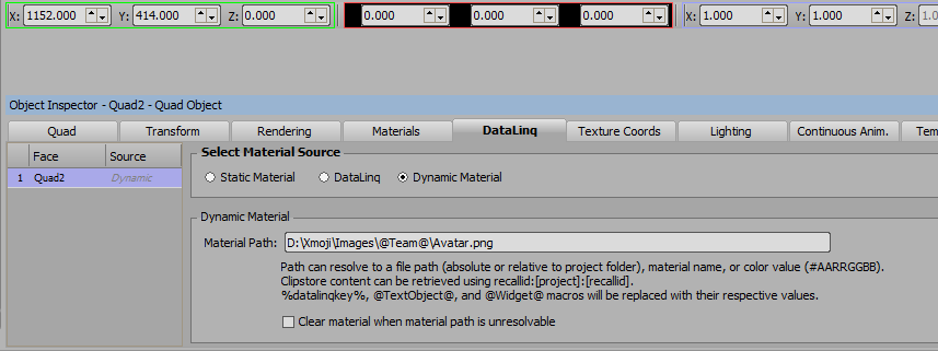

    You can replace part of this path with a text object macro like so.
    So now where the fixed folder called "Home" was it could be all your different team folders such as Home and Away would be and that gets completed by filling in the text object called "Teams"
