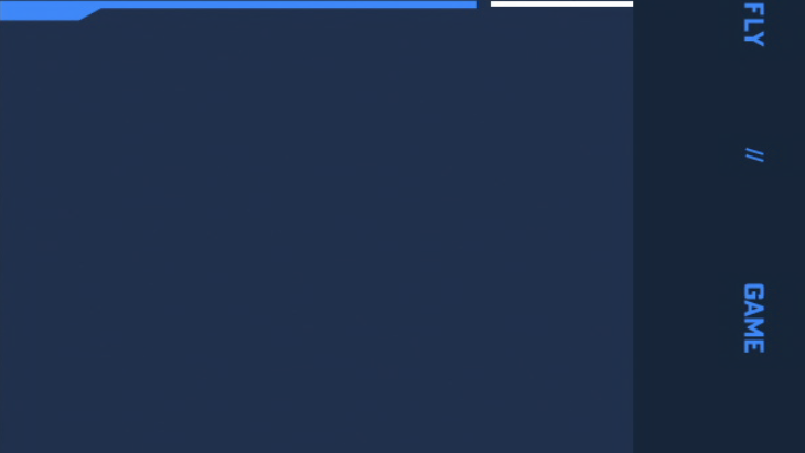

    Screenshots:
    No bands, no pixelation on QuickTime MOV animation:
    Same case with GP Cineform MOV:
    Horizontal bands, pixelation, slight desaturation on XPV2 AVI at default codec settings:

    I have reproduced the banding that you are seeing, but only when rendering the "Main Screen_MOV_anim.mov" file. The "Main Screen_GoPro Cineform.mov" has has no issues rendering into XPVC2. The new render I made straight from the 'Render Queue' looks the same as the one you linked. There are some differences in the underlying codec wrappers between those two files, which I believe to be the cause of this.
    Can you please send me a copy of the original After Effects scene used to do the renders? I would like to export the scene as untouched as possible to eliminate the issue of the difference in codec wrappers from the two files I have been testing.
